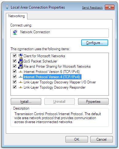

• If needed, repeat the process for IPv6 settings using the following IPv6 addresses
2620:74:1b::1:1
2620:74:1c::2:2
