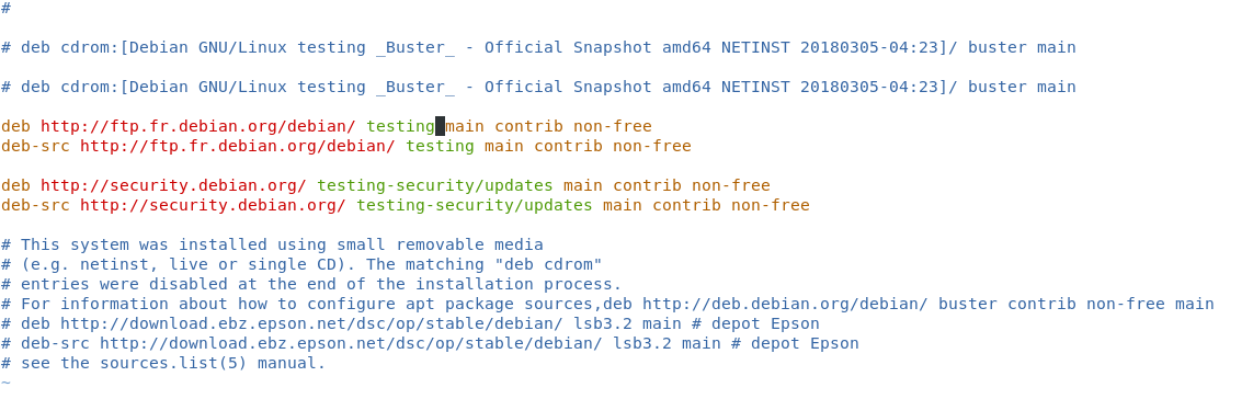

Voici mes sources:
# deb cdrom:[Debian GNU/Linux testing _Buster_ - Official Snapshot amd64 NETINST 20180305-04:23]/ buster main
deb http://ftp.fr.debian.org/debian/ testing main contrib non-free
deb-src http://ftp.fr.debian.org/debian/ testing main contrib non-free
deb http://security.debian.org/ testing-security/updates main contrib non-free
deb-src http://security.debian.org/ testing-security/updates main contrib non-free
# This system was installed using small removable media
# (e.g. netinst, live or single CD). The matching "deb cdrom"
# entries were disabled at the end of the installation process.
# For information about how to configure apt package sources,deb http://deb.debian.org/debian/ buster contrib non-free main
# deb http://download.ebz.epson.net/dsc/op/stable/debian/ lsb3.2 main # depot Epson
# deb-src http://download.ebz.epson.net/dsc/op/stable/debian/ lsb3.2 main # depot Epson
# see the sources.list(5) manual.
est-ce que ce changement de distribution incomplet inspire quelqu’un?
Merci d’avance
