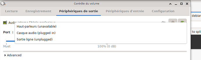

Depuis quelques temps, j’ai un soucis. Sur DELL E7440, souci avec le son (sid à jour)
Si je branche le casque, pas de soucis j’ai du son, par contre, plus rien ne sort du PC sans casque sauf le son système
Le périphérique dans pavucontrol apparait toujours en unavailable
Voici quelques sorties, à priori aucun canal de muter dans alsamixer

pacmd list-sinks
1 sink(s) available.
  * index: 4
	driver: <module-alsa-card.c>
	flags: HARDWARE HW_MUTE_CTRL HW_VOLUME_CTRL DECIBEL_VOLUME LATENCY DYNAMIC_LATENCY
	state: SUSPENDED
	suspend cause: IDLE
	priority: 9039
	volume: front-left: 65536 / 100% / 0,00 dB,   front-right: 65536 / 100% / 0,00 dB
	        balance 0,00
	base volume: 65536 / 100% / 0,00 dB
	volume steps: 65537
	muted: no
	current latency: 0,00 ms
	max request: 0 KiB
	max rewind: 0 KiB
	monitor source: 5
	sample spec: s16le 2ch 44100Hz
	channel map: front-left,front-right
	             Stéréo
	used by: 0
	linked by: 0
	configured latency: 0,00 ms; range is 0,50 .. 2000,00 ms
	card: 1 <alsa_card.pci-0000_00_1b.0>
	module: 7
	properties:
		alsa.resolution_bits = "16"
		device.api = "alsa"
		device.class = "sound"
		alsa.class = "generic"
		alsa.subclass = "generic-mix"
		alsa.name = "ALC3226 Analog"
		alsa.id = "ALC3226 Analog"
		alsa.subdevice = "0"
		alsa.subdevice_name = "subdevice #0"
		alsa.device = "0"
		alsa.card = "1"
		alsa.card_name = "HDA Intel PCH"
		alsa.long_card_name = "HDA Intel PCH at 0xf7e30000 irq 53"
		alsa.driver_name = "snd_hda_intel"
		device.bus_path = "pci-0000:00:1b.0"
		sysfs.path = "/devices/pci0000:00/0000:00:1b.0/sound/card1"
		device.bus = "pci"
		device.vendor.id = "8086"
		device.vendor.name = "Intel Corporation"
		device.product.id = "9c20"
		device.product.name = "8 Series HD Audio Controller"
		device.form_factor = "internal"
		device.string = "front:1"
		device.buffering.buffer_size = "352800"
		device.buffering.fragment_size = "176400"
		device.access_mode = "mmap+timer"
		device.profile.name = "analog-stereo"
		device.profile.description = "Stéréo analogique"
		device.description = "Audio interne Stéréo analogique"
		alsa.mixer_name = "Realtek ALC3226"
		alsa.components = "HDA:10ec0292,102805cb,00100001"
		module-udev-detect.discovered = "1"
		device.icon_name = "audio-card-pci"
	ports:
		analog-output-lineout: Sortie ligne (priority 9000, latency offset 0 usec, available: no)
			properties:
		analog-output-speaker: Haut-parleurs (priority 10000, latency offset 0 usec, available: no)
			properties:
				device.icon_name = "audio-speakers"
		analog-output-headphones: Casque audio (priority 9900, latency offset 0 usec, available: yes)
			properties:
				device.icon_name = "audio-headphones"
	active port: <analog-output-headphones>

(on dirait qu’il considère que le jack est toujours branché et donc ne rend pas la main au speaker, mais je ne sais comment forcer cette action)
Où alors il s’agit d’un problème matériel. Mais dans ce cas je pense que les « beep » système seraient HS également, hors ce n’est pas le cas… A moins qu’ils sortent d’un buzzer indépendant… Ce qui est aussi probable…

J’avais ouvert le chassis un jour pour changer la puce wifi. ça tombe le fil de connexion des HP à la carte son a été débranché… Faudrait que je trouve le courage pour le ré ouvrir car là je ne vois pas d’autres solutions…
