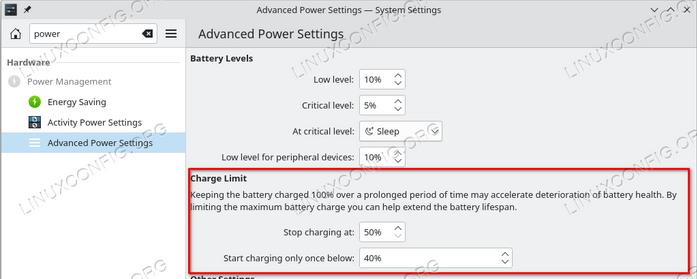

Set Battery Charge Thresholds on Linux
Setting battery charge thresholds from KDE Plasma desktop
KDE plasma is a highly customizable desktop environment which includes a native graphical interface to change battery charge thresholds on notebooks whose firmware support this feature. All we have to do to navigate to “Power Management → Advanced Power Settings” in KDE system settings.
If the notebook firmware exposes the functionality, we should find a widget to set batteries thresholds:
