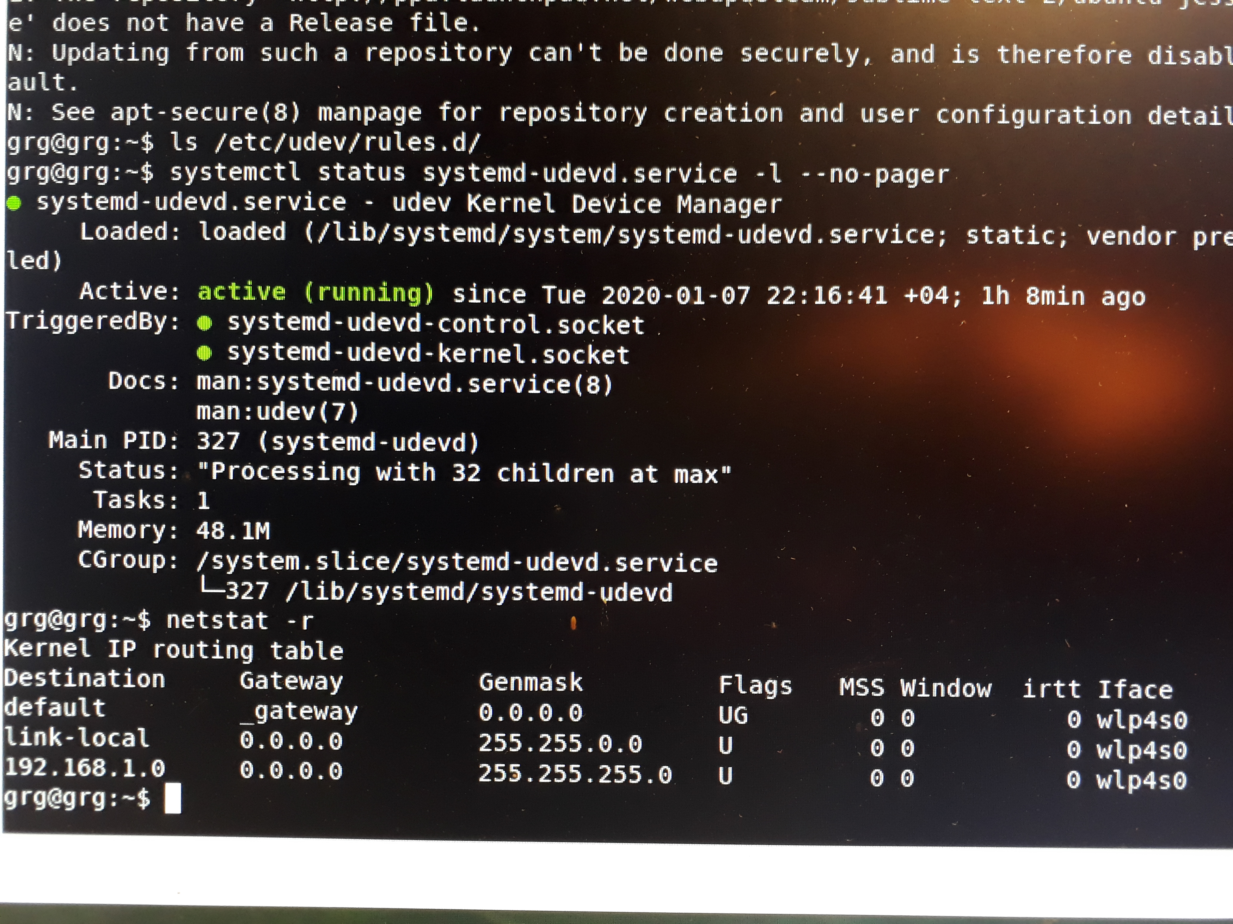

systemctl status  systemd-udevd.service -l --no-pager
● systemd-udevd.service - udev Kernel Device Manager
     Loaded: loaded (/lib/systemd/system/systemd-udevd.service; static; vendor preset: enabled)
     Active: active (running) since Sun 2020-01-05 08:46:52 CET; 33min ago
TriggeredBy: ● systemd-udevd-kernel.socket
             ● systemd-udevd-control.socket
       Docs: man:systemd-udevd.service(8)
             man:udev(7)
   Main PID: 279 (systemd-udevd)
     Status: "Processing with 20 children at max"
      Tasks: 1
     Memory: 42.0M
     CGroup: /system.slice/systemd-udevd.service
             └─279 /lib/systemd/systemd-udevd

netstat -r
Table de routage IP du noyau
Destination     Passerelle      Genmask         Indic   MSS Fenêtre irtt Iface
default         _gateway        0.0.0.0         UG        0 0          0 wlp3s0b1
link-local      0.0.0.0         255.255.0.0     U         0 0          0 wlp3s0b1
192.168.1.0     0.0.0.0         255.255.255.0   U         0 0          0 wlp3s0b1

merci pour vos remarques,
voici ce que me donne systemctl et netstat:
en redémarrant ma connection via:
service network-manager restart
