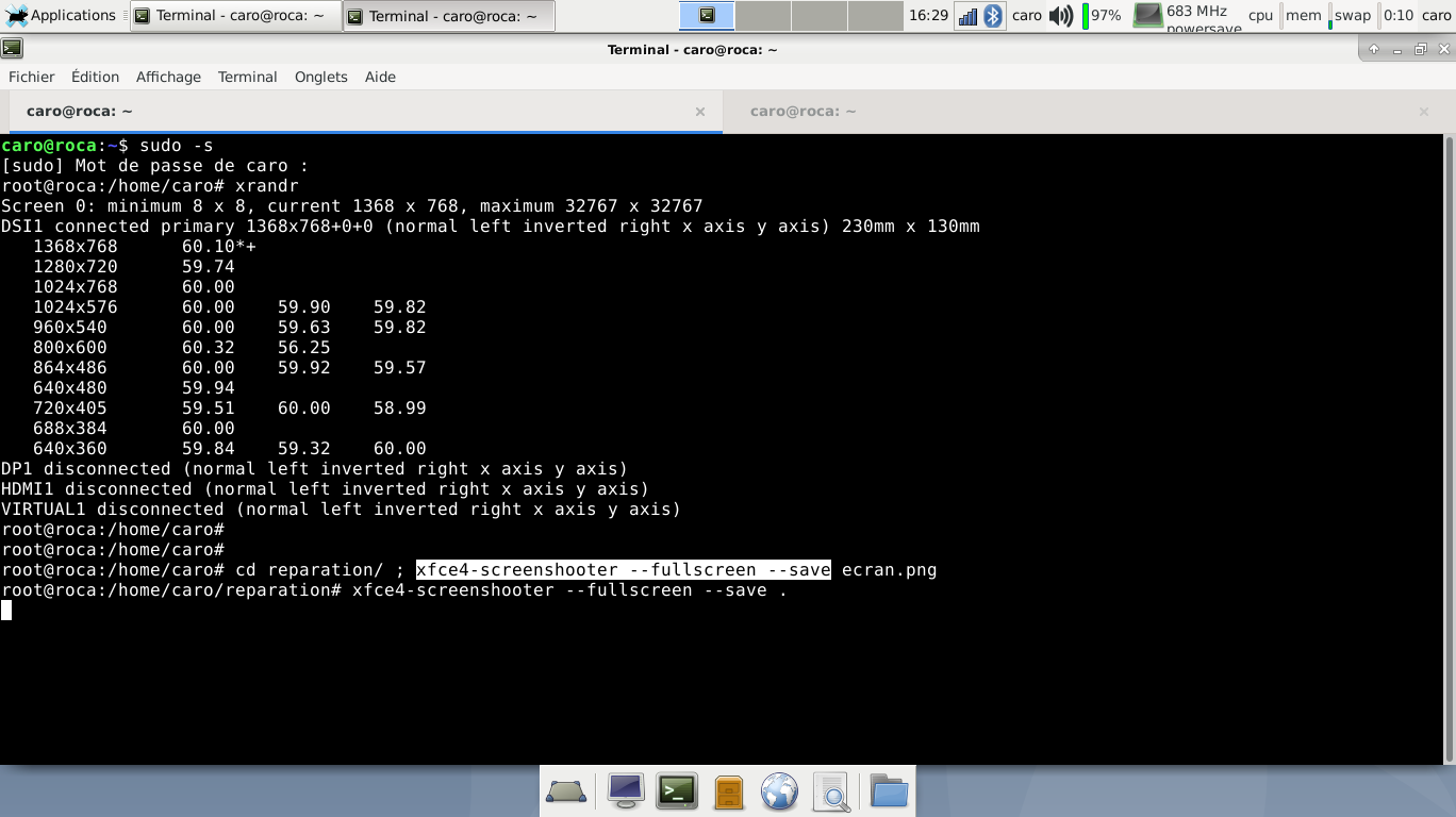

sudo xrandr :
Screen 0: minimum 8 x 8, current 1368 x 768, maximum 32767 x 32767
DSI1 connected primary 1368x768+0+0 (normal left inverted right x axis y axis) 230mm x 130mm
1368x768 60.10*+
1280x720 59.74
1024x768 60.00
1024x576 60.00 59.90 59.82
960x540 60.00 59.63 59.82
800x600 60.32 56.25
864x486 60.00 59.92 59.57
640x480 59.94
720x405 59.51 60.00 58.99
688x384 60.00
640x360 59.84 59.32 60.00
DP1 disconnected (normal left inverted right x axis y axis)
HDMI1 disconnected (normal left inverted right x axis y axis)
VIRTUAL1 disconnected (normal left inverted right x axis y axis)
xfce4-screenshooter --fullscreen --save ~/capture.png
