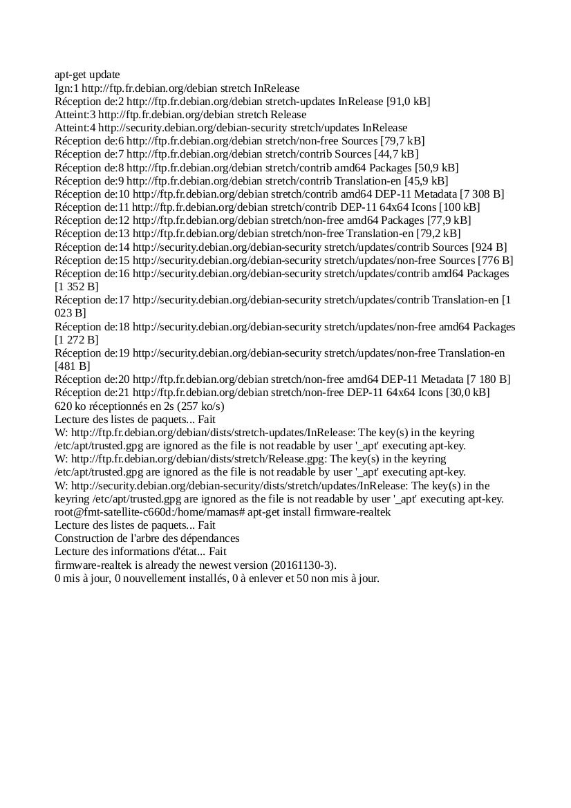

Ah oui en effet, autant pour moi, j’avais mal regardé. C’est assez exotique, oui. Il serait plus propre de ne plus avoir de doublon dans le sources.list (soit supprimer ces 2 lignes, soit supprimer
deb http://ftp.fr.debian.org/debian/ stretch main
deb-src http://ftp.fr.debian.org/debian/ stretch main)
Je viens de faire les modifs.
Ci joint, les lignes après l’update
J’ai relancé mais l’icône du wifi reste toujours grisé.

oct. 05 12:32:38 fmt-satellite-c660d NetworkManager[423]: <info>  [1507199558.5891] Loaded device plugin: NMVxlanDeviceFactory (internal)
oct. 05 12:32:38 fmt-satellite-c660d NetworkManager[423]: <info>  [1507199558.6373] Loaded device plugin: NMBluezManager (/usr/lib/x86_64-linux-gnu/NetworkManager/libnm-device-plugin-bluetooth.so)
oct. 05 12:32:38 fmt-satellite-c660d NetworkManager[423]: <info>  [1507199558.6845] Loaded device plugin: NMAtmManager (/usr/lib/x86_64-linux-gnu/NetworkManager/libnm-device-plugin-adsl.so)
oct. 05 12:32:38 fmt-satellite-c660d NetworkManager[423]: <info>  [1507199558.7156] Loaded device plugin: NMTeamFactory (/usr/lib/x86_64-linux-gnu/NetworkManager/libnm-device-plugin-team.so)
oct. 05 12:32:38 fmt-satellite-c660d NetworkManager[423]: <info>  [1507199558.7340] Loaded device plugin: NMWifiFactory (/usr/lib/x86_64-linux-gnu/NetworkManager/libnm-device-plugin-wifi.so)
oct. 05 12:32:38 fmt-satellite-c660d NetworkManager[423]: <info>  [1507199558.7372] Loaded device plugin: NMWwanFactory (/usr/lib/x86_64-linux-gnu/NetworkManager/libnm-device-plugin-wwan.so)
oct. 05 12:32:38 fmt-satellite-c660d NetworkManager[423]: <info>  [1507199558.7755] device (lo): link connected
oct. 05 12:32:38 fmt-satellite-c660d NetworkManager[423]: <info>  [1507199558.7802] manager: (lo): new Generic device (/org/freedesktop/NetworkManager/Devices/1)
oct. 05 12:32:38 fmt-satellite-c660d NetworkManager[423]: <info>  [1507199558.7911] manager: (enp1s0): new Ethernet device (/org/freedesktop/NetworkManager/Devices/2)
oct. 05 12:32:38 fmt-satellite-c660d NetworkManager[423]: <info>  [1507199558.8030] device (enp1s0): state change: unmanaged -> unavailable (reason 'managed') [10 20 2]
oct. 05 12:32:39 fmt-satellite-c660d NetworkManager[423]: <info>  [1507199559.0632] (wlp2s0): using nl80211 for WiFi device control
oct. 05 12:32:39 fmt-satellite-c660d NetworkManager[423]: <info>  [1507199559.0645] device (wlp2s0): driver supports Access Point (AP) mode
oct. 05 12:32:39 fmt-satellite-c660d NetworkManager[423]: <info>  [1507199559.0702] manager: (wlp2s0): new 802.11 WiFi device (/org/freedesktop/NetworkManager/Devices/3)
oct. 05 12:32:39 fmt-satellite-c660d NetworkManager[423]: <info>  [1507199559.0853] manager: NetworkManager state is now CONNECTED_GLOBAL
oct. 05 12:32:39 fmt-satellite-c660d NetworkManager[423]: <info>  [1507199559.1739] ModemManager available in the bus
oct. 05 12:32:39 fmt-satellite-c660d NetworkManager[423]: <info>  [1507199559.3702] supplicant: wpa_supplicant running
oct. 05 12:32:44 fmt-satellite-c660d NetworkManager[423]: <info>  [1507199564.4579] manager: startup complete
-- Subject: L'unité (unit) NetworkManager-wait-online.service a terminé son démarrage
-- L'unité (unit) NetworkManager-wait-online.service a terminé son démarrage, avec le résultat done.
moi je fonctionne avec ifupdown unmanaged
oct. 05 11:09:42 debian NetworkManager[623]: <info>  [1507194582.4456] init!
oct. 05 11:09:42 debian NetworkManager[623]: <info>  [1507194582.4459]       interface-parser: parsing file /etc/network/interfaces
oct. 05 11:09:42 debian NetworkManager[623]: <info>  [1507194582.4460]       interface-parser: source line includes interfaces file(s) /etc/network/interfaces.d/*
oct. 05 11:09:42 debian NetworkManager[623]: <warn>  [1507194582.4461] interfaces file /etc/network/interfaces.d/* doesn't exist
oct. 05 11:09:42 debian NetworkManager[623]: <info>  [1507194582.4462]       interface-parser: finished parsing file /etc/network/interfaces
oct. 05 11:09:42 debian NetworkManager[623]: <info>  [1507194582.4462] management mode: unmanaged
cat /etc/NetworkManager/NetworkManager.conf
[main]
plugins=ifupdown,keyfile
[ifupdown]
managed=false
chez toi ce message est problématique
oct. 05 12:32:38 fmt-satellite-c660d NetworkManager423: [1507199558.1020] deleting wlp2s0 from connections
oct. 05 12:32:38 fmt-satellite-c660d NetworkManager assertion '' failed
Je suis sous Gnome.
Pour visualiser les paramètres wifi, je clique sur l’icône en haut à droite de l’écran puis “paramètres wifi”. Ensuite il y a une nouvelle fenêtre qui s’ouvre.
Oui, donc, “l’icône en haut à droite de l’écran” c’est celle de l’Applet NetworkManager,
et il te faut donc supprimer les lignes concernant l’interface WiFi qui sont dans ton fichier /etc/network/interfaces
Ce qui fait que le contenu de /etc/network/interfaces ne contiendra que les lignes ci-dessous :
