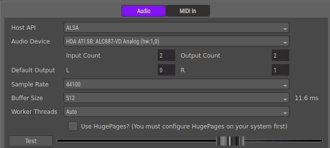

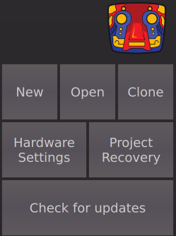

Seems to work fine.
2023-11-13_21-25
2023-11-13_21-26
2 J'aime
