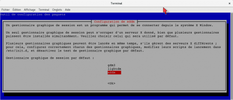

J’ai exactement le même problème… et ca me parait anormale de marquer le post comme résolu (une réinstallation résoudrait tous les post de ce forum !!).
De mon coté, je soupçonne qu’il manque un service systemd faisant appel à sddm.service.
Comme pour hoby1, si je lance startx
ou systemctl start sddm
, le DM se lance.
Par contre lorsque je fais un systemctl enable sddm.service
, j’ai un message qui m’annonce que le service est static:
The unit files have no installation config (WantedBy, RequiredBy, Also, Alias
settings in the [Install] section, and DefaultInstance for template units).
This means they are not meant to be enabled using systemctl.
Possible reasons for having this kind of units are:
- A unit may be statically enabled by being symlinked from another unit’s
.wants/ or .requires/ directory.
- A unit’s purpose may be to act as a helper for some other unit which has
a requirement dependency on it.
- A unit may be started when needed via activation (socket, path, timer,
D-Bus, udev, scripted systemctl call, …).
- In case of template units, the unit is meant to be enabled with some
instance name specified.
Pb, je ne trouve pas quel service devrait utiliser ou declencher l’appel à sddm.service. Une idée ?
