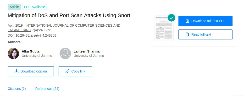

Screenshot_2021-02-17 (PDF) Mitigation of DoS and Port Scan Attacks Using Snort
