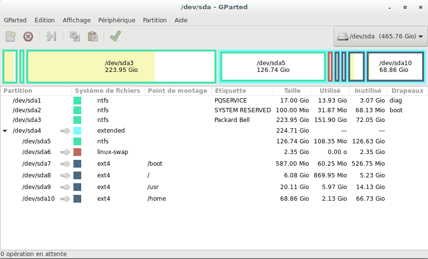

Enfin, voilà mon rapport bootinfoscript (créé après résolution du problème) :
                  Boot Info Script 0.61      [1 April 2012]
============================= Boot Info Summary: ===============================
 => Windows is installed in the MBR of /dev/sda.
sda1: __________________________________________________________________________
    File system:       ntfs
    Boot sector type:  Windows Vista/7: NTFS
    Boot sector info:  No errors found in the Boot Parameter Block.
    Operating System:
    Boot files:        /BOOTMGR /BOOT/BCD
sda2: __________________________________________________________________________
    File system:       ntfs
    Operating System:
    Boot files:        /bootmgr /Boot/BCD
sda3: __________________________________________________________________________
    File system:       ntfs
    Boot file info:      Grub2 (v1.97-1.98) in the file /bootsect.lnx looks at
                       sector 895003202 of the same hard drive for core.img,
                       but core.img can not be found at this location.
    Operating System:
    Boot files:        /Windows/System32/winload.exe
sda4: __________________________________________________________________________
    File system:       Extended Partition
    Boot sector type:  Grub2 (v1.99)
    Boot sector info:  Grub2 (v1.99) is installed in the boot sector of sda4
                       and looks at sector 776520760 of the same hard drive
                       for core.img. core.img is at this location and looks
                       in partition 85 for .
sda5: __________________________________________________________________________
    File system:       ntfs
    Operating System:
    Boot files:
sda6: __________________________________________________________________________
    File system:       swap
    Boot sector type:  -
    Boot sector info:
sda7: __________________________________________________________________________
    File system:       ext4
    Boot sector info:  Grub2 (v1.99) is installed in the boot sector of sda7
    Operating System:
    Boot files:        /grub/grub.cfg
sda8: __________________________________________________________________________
    File system:       ext4
    Boot sector type:  -
    Boot sector info:
    Operating System:  Debian GNU/Linux 9
    Boot files:        /etc/fstab
sda9: __________________________________________________________________________
    File system:       ext4
    Boot sector type:  -
    Boot sector info:
    Operating System:
    Boot files:
sda10: _________________________________________________________________________
    File system:       ext4
    Boot sector type:  -
    Boot sector info:
    Operating System:
    Boot files:
============================ Drive/Partition Info: =============================
Drive: sda _____________________________________________________________________
Disque /dev/sda : 465,8 GiB, 500107862016 octets, 976773168 secteurs
Type d'étiquette de disque : dos
Partition  Boot  Start Sector    End Sector  # of Sectors  Id System
/dev/sda1               2,048    35,653,631    35,651,584  27 Hidden NTFS (Recovery Environment)
/dev/sda2          35,653,632    35,858,431       204,800   7 NTFS / exFAT / HPFS
/dev/sda3          35,858,432   505,518,079   469,659,648   7 NTFS / exFAT / HPFS
/dev/sda4    *    505,520,126   976,773,119   471,252,994   5 Extended
/dev/sda5         505,520,128   771,307,519   265,787,392   7 NTFS / exFAT / HPFS
/dev/sda6         771,309,568   776,241,151     4,931,584  82 Linux swap / Solaris
/dev/sda7         776,243,200   777,445,375     1,202,176  83 Linux
/dev/sda8         777,447,424   790,204,415    12,756,992  83 Linux
/dev/sda9         790,206,464   832,370,687    42,164,224  83 Linux
/dev/sda10        832,372,736   976,773,119   144,400,384  83 Linux
"blkid" output: ________________________________________________________________
Device           UUID                                   TYPE       LABEL
/dev/sda1        0A7C804A7C80328D                       ntfs       PQSERVICE
/dev/sda10       a4753cd5-51e4-4b3d-bcff-e481fbdee134   ext4
/dev/sda2        523480AB3480941F                       ntfs       SYSTEM RESERVED
/dev/sda3        529CE4B69CE4962F                       ntfs       Packard Bell
/dev/sda5        397C44D0289A932C                       ntfs
/dev/sda6        7093c3f9-4d69-444d-994b-f42157386961   swap
/dev/sda7        fe76e2f4-ea25-4573-b2c7-3c99f1cd6883   ext4
/dev/sda8        694cd22c-2446-4218-ac96-2e8c99b8a1bf   ext4
/dev/sda9        a84da28c-ef04-43aa-bd39-fee0c952927a   ext4
================================ Mount points: =================================
Device           Mount_Point              Type       Options
/dev/sda10       /home                    ext4       (rw,relatime,data=ordered)
/dev/sda7        /boot                    ext4       (rw,relatime,data=ordered)
/dev/sda8        /                        ext4       (rw,relatime,errors=remount-ro,data=ordered)
/dev/sda9        /usr                     ext4       (rw,relatime,data=ordered)

		initrd	/initrd.img-4.9.0-6-amd64
### END /etc/grub.d/10_linux ###
### BEGIN /etc/grub.d/20_linux_xen ###
### END /etc/grub.d/20_linux_xen ###
### BEGIN /etc/grub.d/30_os-prober ###
menuentry 'Windows Recovery Environment (sur /dev/sda1)' --class windows --class os $menuentry_id_option 'osprober-chain-0A7C804A7C80328D' {
	insmod part_msdos
	insmod ntfs
	set root='hd0,msdos1'
	if [ x$feature_platform_search_hint = xy ]; then
	  search --no-floppy --fs-uuid --set=root --hint-bios=hd0,msdos1 --hint-efi=hd0,msdos1 --hint-baremetal=ahci0,msdos1  0A7C804A7C80328D
	else
	  search --no-floppy --fs-uuid --set=root 0A7C804A7C80328D
	fi
	parttool ${root} hidden-
	drivemap -s (hd0) ${root}
	chainloader +1
menuentry 'Windows 10 (sur /dev/sda2)' --class windows --class os $menuentry_id_option 'osprober-chain-523480AB3480941F' {
	insmod part_msdos
	insmod ntfs
	set root='hd0,msdos2'
	  search --no-floppy --fs-uuid --set=root --hint-bios=hd0,msdos2 --hint-efi=hd0,msdos2 --hint-baremetal=ahci0,msdos2  523480AB3480941F
	else
	  search --no-floppy --fs-uuid --set=root 523480AB3480941F
	fi
	chainloader +1
### END /etc/grub.d/30_os-prober ###
### BEGIN /etc/grub.d/30_uefi-firmware ###
### END /etc/grub.d/30_uefi-firmware ###
### BEGIN /etc/grub.d/40_custom ###
# This file provides an easy way to add custom menu entries.  Simply type the
# menu entries you want to add after this comment.  Be careful not to change
# the 'exec tail' line above.
### END /etc/grub.d/40_custom ###
### BEGIN /etc/grub.d/41_custom ###
if [ -f  ${config_directory}/custom.cfg ]; then
  source ${config_directory}/custom.cfg
elif [ -z "${config_directory}" -a -f  $prefix/custom.cfg ]; then
  source $prefix/custom.cfg;
fi
### END /etc/grub.d/41_custom ###
=================== sda7: Location of files loaded by Grub: ====================
           GiB - GB             File                                 Fragment(s)
=============================== sda8/etc/fstab: ================================
# /etc/fstab: static file system information.
# Use 'blkid' to print the universally unique identifier for a
# device; this may be used with UUID= as a more robust way to name devices
# that works even if disks are added and removed. See fstab(5).
# <file system> <mount point>   <type>  <options>       <dump>  <pass>
# / was on /dev/sda8 during installation
UUID=694cd22c-2446-4218-ac96-2e8c99b8a1bf /               ext4    errors=remount-ro 0       1
# /boot was on /dev/sda7 during installation
UUID=fe76e2f4-ea25-4573-b2c7-3c99f1cd6883 /boot           ext4    defaults        0       2
# /home was on /dev/sda10 during installation
UUID=a4753cd5-51e4-4b3d-bcff-e481fbdee134 /home           ext4    defaults        0       2
# /usr was on /dev/sda9 during installation
UUID=a84da28c-ef04-43aa-bd39-fee0c952927a /usr            ext4    defaults        0       2
# swap was on /dev/sda6 during installation
UUID=7093c3f9-4d69-444d-994b-f42157386961 none            swap    sw              0       0
/dev/sr0        /media/cdrom0   udf,iso9660 user,noauto     0       0
=================== sda8: Location of files loaded by Grub: ====================
========= Devices which don't seem to have a corresponding hard drive: =========
sdb sdc sdd sde
=============================== StdErr Messages: ===============================
cat: /tmp/BootInfo-86ZTWY3D/Tmp_Log: Aucun fichier ou dossier de ce type
