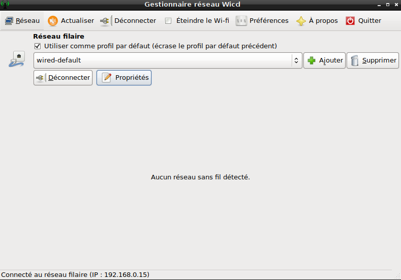

Je rève ou on voit un réseau ???
root@HAL-LINUX:/home/titi# ip addr
1: lo: <LOOPBACK,UP,LOWER_UP> mtu 65536 qdisc noqueue state UNKNOWN group default qlen 1
    link/loopback 00:00:00:00:00:00 brd 00:00:00:00:00:00
    inet 127.0.0.1/8 scope host lo
    inet6 ::1/128 scope host
2: enp2s0: <BROADCAST,MULTICAST,UP,LOWER_UP> mtu 1500 qdisc pfifo_fast state UP group default qlen 1000
    link/ether 00:16:cb:9a:e5:83 brd ff:ff:ff:ff:ff:ff
    inet 192.168.0.15/24 brd 192.168.0.255 scope global enp2s0
    inet6 2a01:e34:ec9b:9430:216:cbff:fe9a:e583/64 scope global mngtmpaddr dynamic
       valid_lft 86335sec preferred_lft 86335sec
    inet6 fe80::216:cbff:fe9a:e583/64 scope link
3: wlan0: <BROADCAST,MULTICAST> mtu 1500 qdisc noop state DOWN group default qlen 1000
    link/ether 00:17:f2:98:b8:87 brd ff:ff:ff:ff:ff:

Capture du 2018-03-01 18-36-24
Je n’y comprends rien !!!
